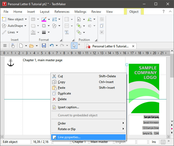

A vertical line could help separate the letterhead data from the body text. Close the print preview, return to master page view and choose Insert | Lines | Line. Click on a spot between the top of the sample logo and the right page margin, hold Shift and drag the mouse down until you reach the bottom of the footer.
The Shift key modifier constrains the line and rotation angles. Lines are constrained to 45 degree increments, picture frames rotate in 22.5 degree increments. The latter will become important further on.
The result is a thin vertical line, spaced more or less evenly between the logo and the right page margin. In case the position or length aren't quite right, the line can always be adjusted either using the mouse or – you've probably guessed it already – its Properties dialog box.
For the latter approach, right-click on the line and select Line properties from the context menu. To make things easier for me, I set the horizontal position to "Right" and adjusted the offset to 5.25 cm. Then I made sure the offset for the vertical position was an even 1 cm.
The length of the line could also be adjusted through the Properties dialog box (Format tab, "Height"), but this approach is cumbersome since there is no "Apply" button – you'd have to change the height value, click OK, check the result, re-open the line properties, edit the value, click OK ... Instead, I chose to drag the bottom point of the line to an acceptable height by hand (with some aid from the Shift key).
A quick check of the results in the print preview – yeah, that looks decent. At this point, I decided to set the line color to 50% gray (Object properties, "Lines" tab) and I widened the right-hand page margin to 5.75 cm – but these steps are entirely optional. Should you decide that you want the paragraphs of your letter to be justified, you might want to add another couple of millimeters to the right margin.
